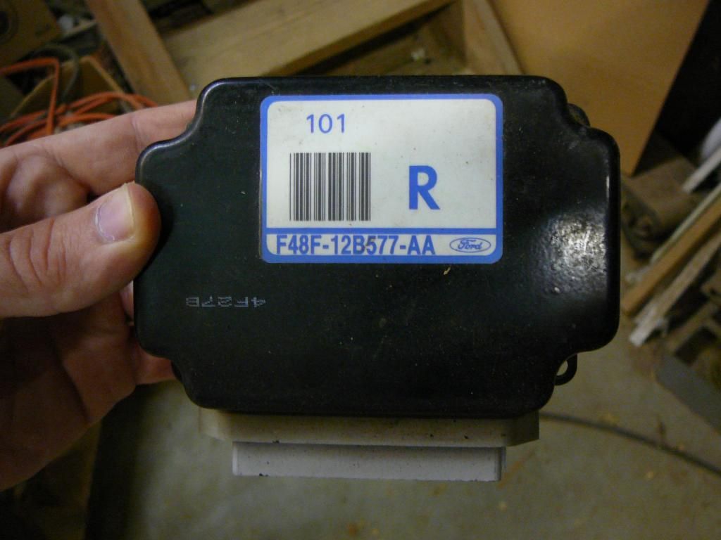

Can you tell me where exactly that CCRM is so that I can check the voltage? Is that the thing on the passenger side behind the headlight? Wonder where I can find a pic of that? All my fuses seem to be fine.
Yep. It'll look very similar to this (this one is for a '94+).
