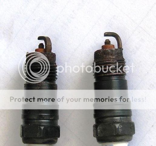

Plugs 3 & 6...
2 & 5 have moisture damage as well.
6 was not even firing.

Well, I replaced the bad plugs, put it all back together and it is running just fine again. I think the head bolts I used just loosened up and are seeping water into some of the cylinders. I may just put the new head bolts and call it a day.

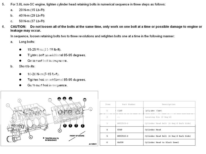

According to the service manual, you need to tighten the bolts in stages (see diagram). Since I am replacing the head bolts only and should only do them one at a time, do I follow the steps suggested or just replace the bolt, tighten to max spec and move on the next bolt in sequence?

You need to tighten to 37 ft/lb, loosen, then final torque (11-18 ft/lb or 7-15 ft/lb), then the additional 85-95 (1/4 turn). Do one bolt at a time to keep the clamp pressure on the gasket. The reason for the tighten, then loosen is to stretch the bolt (I believe).
