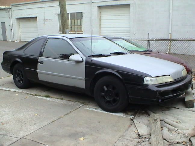

looks like a police car who's LT1 is that, or is it a sixer?
2014 GT
1990 300ZX TT
big mike is offline
post #6 of 12 (permalink) Old 10-11-2005, 03:28 PM Thread Starter
MaleWhore
smokymance's Avatar
Join Date: Oct 2003
Location: Commerce , MI
Posts: 2,640
yeah...thats what i was trying to copy from..our cop cars are white and black...lol
yeah...thats an lt1
