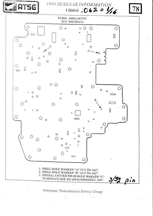

Tsb
If a Merc V fluid/filter change/upgrade doesn't correct your problem, you can try this shudder fix:
