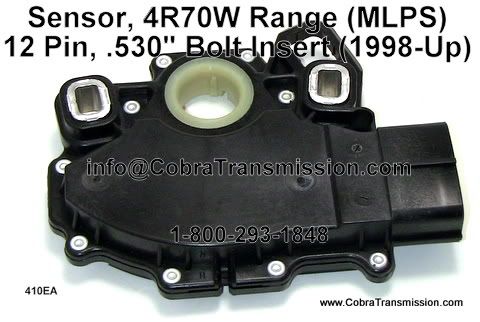

where can i find the mlps do you have a picture on where is located ??
CASTRO847 is offline
post #14 of 33 (permalink) Old 12-30-2010, 10:23 AM
This is an MLPS:
Here is a 4R70W transmission (the MLPS is clearly visible on the side):
~Rick
TCCoA Sig
