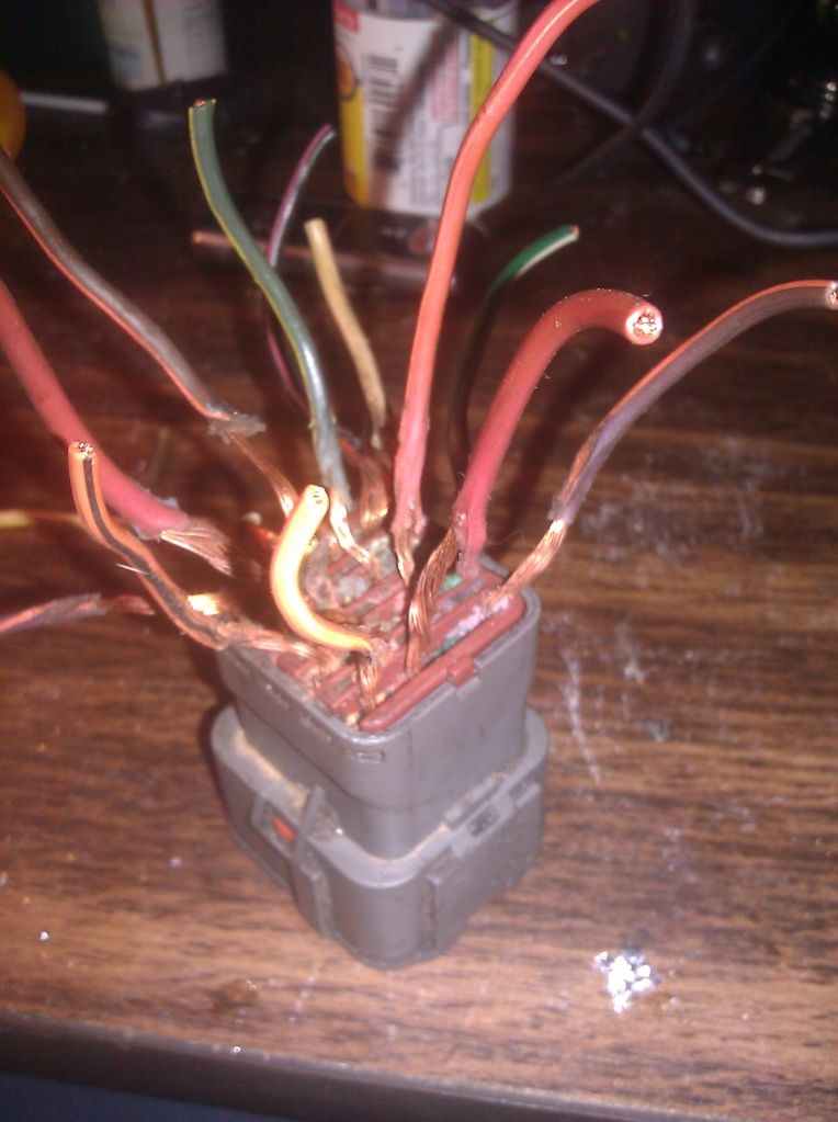

Hadnt messed with it really until now. My harness is ate up with bare wires touching all over the place. I know what my weekend project is going to be...
edit- Here's a pic. The wires to this plug where the insulation was exposed was brittle from the heat. ALL of the wires had broken insulation. No wonder I was having issues. Took the plug off my other harness and soldered it to this one and insulated the wires better. About to go reinstall the harness. There were a couple other minor wire issues but this was the main culprit.

I had to solder my harness too. Those connectors have replaceable pins, so you can repair individual circuits, but I couldn't find any parts stores that had the right size pins. Not even the Ford dealer. So I had to solder and butt-connect a new piece of wire in. I only had to take care of one wire; it was only hanging on by 3 strands!

Good that you found it, how do you suspect that happened ?? Crushed during installation of new transmission ? Pins not fully lined up while connecting harness ?

I think years of heat weakened the insulation and then changing the transmission sealed its fate.

Those wires do get pretty brittle after almost 20 years!

Come to find out the male side of the plug is just as bad as the female side was. That one I do not have. I will be sending a PM.
