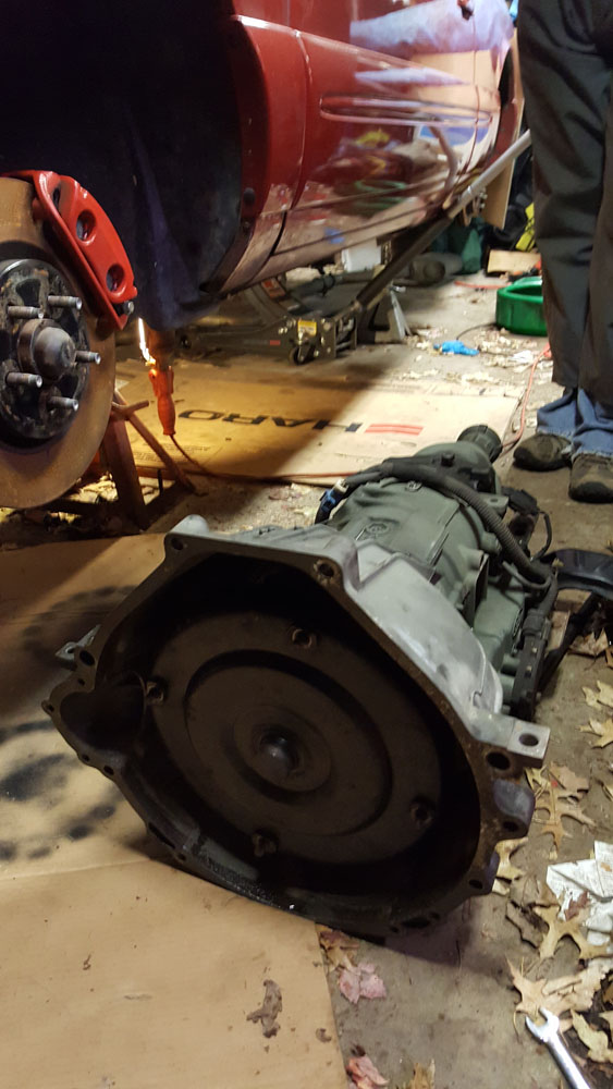

post #20 of 31 (permalink) Old 03-01-2018, 07:42 AM Thread Starter
Posts: 9,041
Making some progress on the replacement.
Slowly making progress getting the underside of the car ripped apart over the last 6 weeks, and last night my buddy brought his friend's trans jack over and we yanked the thing. Came out easily, which was nice. No shavings or particles in the pan or fluid that I could see either...
I'm serious - if anyone wants the old converter, it's theirs to experiment with for whatever it costs to ship.
Not surprisingly (to me - OR to Darrin), the trans that came out of the car is a 97 trans, NOT the 2004 trans I paid Alan for back in 2012. I wouldn't be surprised if all he did was take it out to put the TC in and clean it then paint it gray (all the tags were painted over) before reinstalling it... Which would explain why it failed after 157,000 miles - 130,000 miles of normal use then 27,000 miles of relative abuse. We'll know for sure after I take it to Darrin and let him tear it apart to see what the story behind it really was.
Darrin will be working on my new trans next week. If I have it my way, I'll have this thing back together before the end of the month.
If you are implying what I think you are implying, I'm sorry if this happened to you. This might be a good lesson for everyone -- its always good to mark up a piece of hardware you are sending out for repair work just to make sure what you receive in the end is what you are expecting to get. Even if you are "ruining" the originality of some item, let's be real here: it's not like we are talking about some unobtanium parts like pre-war BMW or 70s Lambo bits. One other explanation could be that you received 2004 trans guts in your original case -- I don't know if that would fit or if that makes sense (I'm not an auto transmission guy), but if my proposed scenario was true you SHOULD have gotten an explanation here.

Well, 9 months later and she's back on the road!
The Circle D converter has better low RPM creep than the DD converter but loosens up when you get on it so it feels like it's about the same stall (supposedly 3400-3600). Lockup is much improved; I have my tune set up to lock the converter more or less immediately after the 1-2 shift (to keep noise/attention to a minimum and also to help a bit with economy) around town and before, the application of the clutch would sometimes do what I wanted (quick but not jarring application) and sometimes slam like I was at WOT, shaking the whole drive train and car along with it. In my time on the roads this afternoon, consistently a smooth application - just how I wanted it.
Trans shifts are very precise. Quick and uneventful, no loud "clank" sounds like the old one made when shifting. I haven't beaten on it yet but my first impressions are very good so far. I'm tentatively planning to take it out for an "extended" drive tomorrow (I'm taking it to work and tomorrow I'm heading to Huron, which is about 35 miles at 75 MPH) to see how it behaves on the open road.
I asked Darrin for a brief breakdown of the details of what the build consisted of (e.g. which parts from which year trans, valve body/spring setup etc.) which I imagine I'll be getting when he does the teardown of the old one. He and I both expect it to be the stock 97 trans; I figure DD might've slapped a different valve body on it but the internals... not counting on anything but stock 97 hardware there. For posterity (and kicks!) here's what I was told I would be getting... and I now see how he was masking his true intentions by virtually begging me to let him install his hackjob so I wouldn't catch on right away!

Darrin gets props for another job well done on this one. Pleased with his attitude, knowledge, attention to my needs, professionalism and candor, and product.
