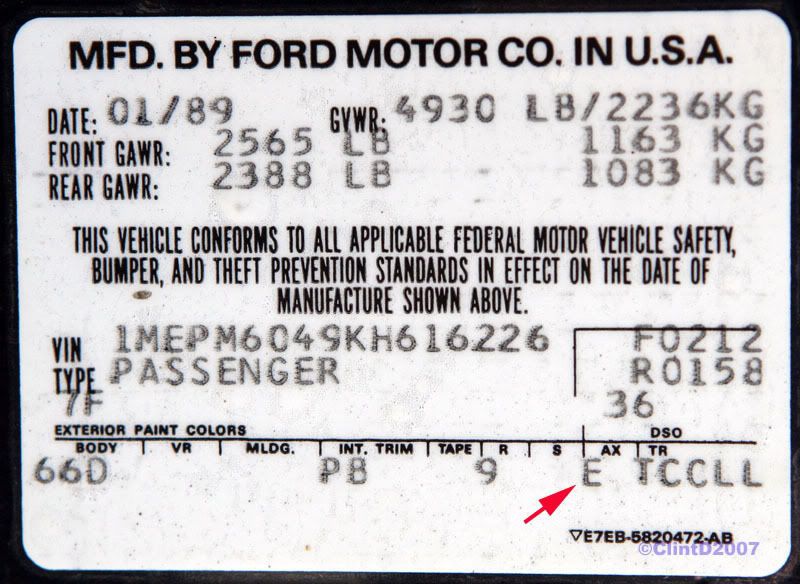

find a cougar or T-bird with a axle code E for a nice 3.27 Track-Loc differential.
don't forget to grab the speedo gear!

Most of the V8 mn12's came with 3.08 open diffs (code Y)
