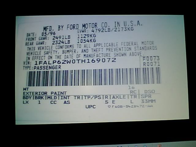

Hey i beleive this is a 3.08 open 8.8" dif... i ripped the tag off the top of the dif and ripped off a number i think. i asked this before in the newbie forum but i want to confirm, the car is a 1995 cougar xr7 with electronic traction control, the tag reads "S510F" and under (i think its missing a number at beginning) "08 88 5B24",
any thoughts?
1995 Cougar XR-7 4.6, stock 3.08s and a 4R70W trans

Garrett look at the sticker on your drivers side door jam under axle code. You will fine what the letter means in the forums. I have a E under axle code = 3:27 TL

The S510F does come up as a 3.08 axle in the Ford parts catalogue, but it doesn't show if it is a locker or open. If it is the original, it will be an open diff. with traction control.
But check the door tag as mentioned, to be sure.

i think then that it def. is a open 3.08 they didnt put electronic traction control in the cars with the trac lok unit. just wanted to make sure.
what would you guys reccommend running in this? daily driver, something i can buy at autozone... what type /make of lube? any additives?
