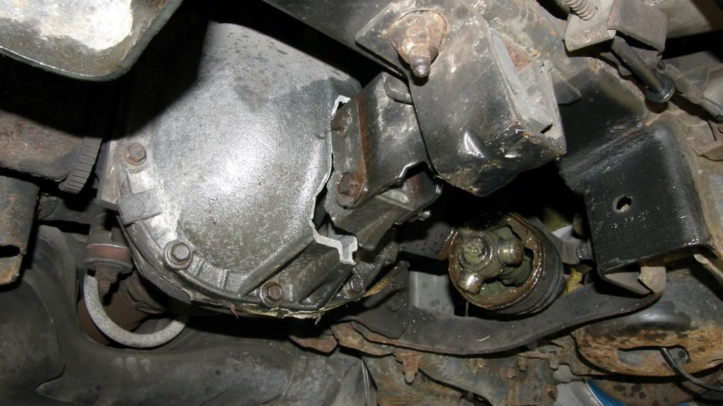

Joker found a way to kill his...
I'm not sure if any amount of reinforcement of the stock rear end could have prevented this.

All those pics can't be of the same rear end. In the first pic, the axle is pulled out of the pumpkin; in the last pic, they are both installed.

They are of the same rear end. You can see the axle hanging where it's seperated in the lower left hand corner of the last picture.
Oh yeh, I see it now. Good eye, Ron!
LOL, I should know. I took the pictures.

I've recently upgraded both cars to include a heavier diff cover and rear diff mount, and also upgraded the halfshafts on the 93 SC.

Ive got the same LPW cover on mine, I liked how you can adjust the load on the carrier bearings. It wasn't cheap though, and filling up the diff with fluid was a nightmare.

I'm considering putting my leftover 8.8 in my car over my shi*ty getrag rearend, if that says anything about how strong these rearends are!
