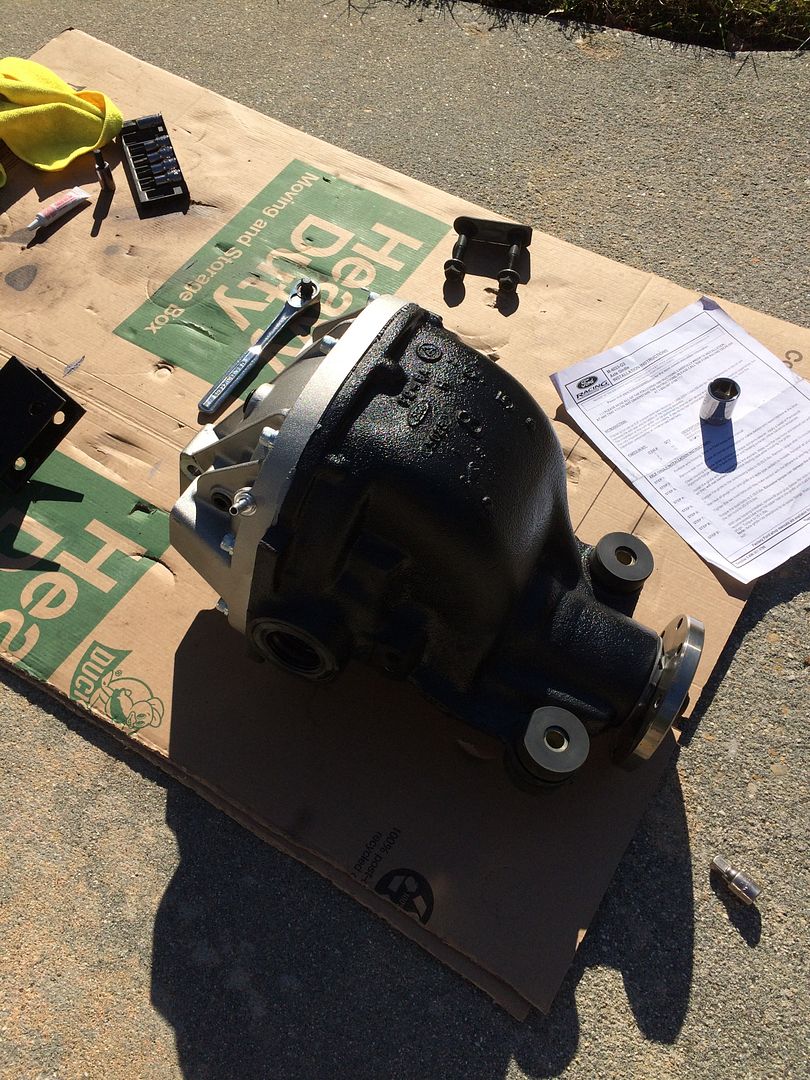

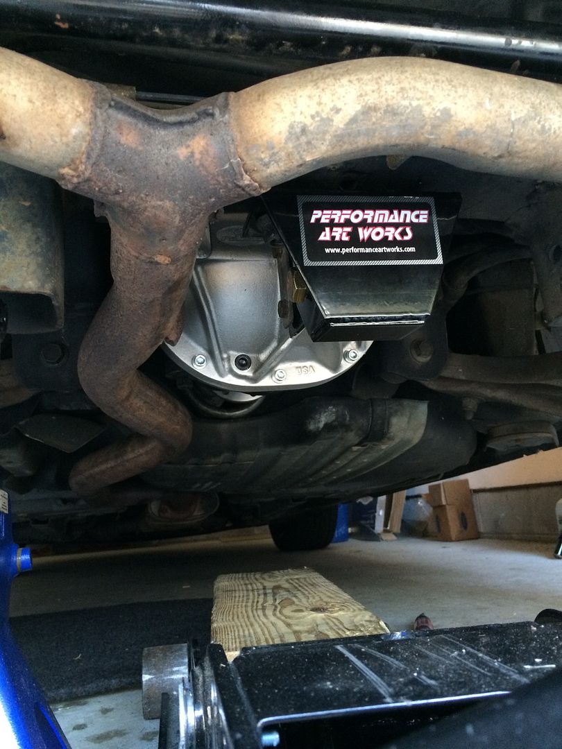

My Differential is bullet proof, and I'm using a manual transmission with high gear ratios in it. My setup is a cast iron housing, with 3.73 traction lock, cobra carbon fiber clutch packs, GT500 pinion bearing, 03 cobra pinion flange, Ford racing IRS differential girdle (needs slight grinding but fits like a glove), and a performance art works differential rear mount with poly front diff bushings. This setup is the bees knees. I RECOMMEND THE SOLID PINION SPACER!!! I got mine from Yukon gear and axle. It's a great piece of hardware with a shim kit so you can get the preload set just right, it is also impossible for it to lose tension, or crush further from insane launches; so far I've given the whole setup hell and it just takes it like a champ.
Any questions, lemme know; I set it all up myself.

From helping build this differential, it is whisper quiet.
